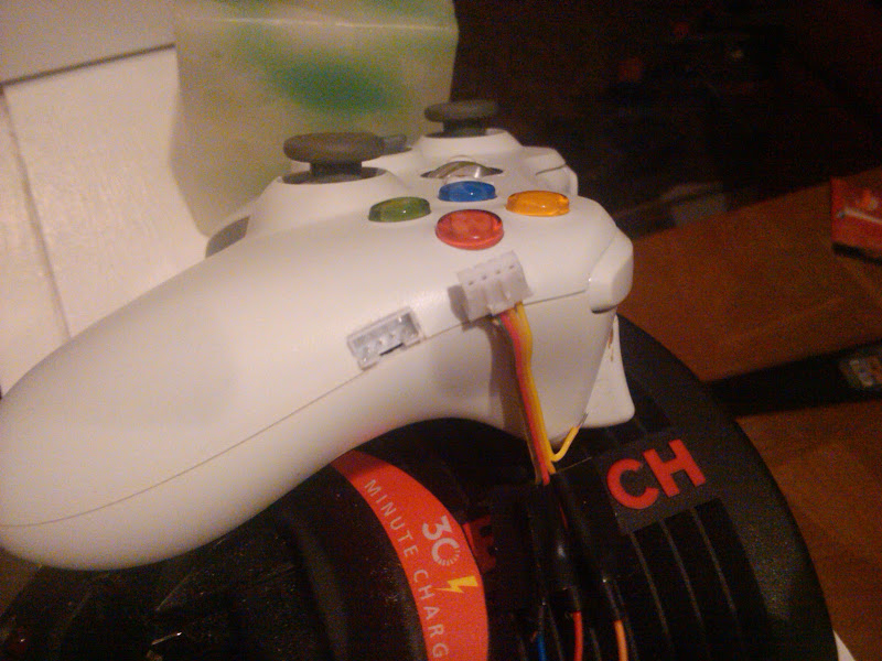

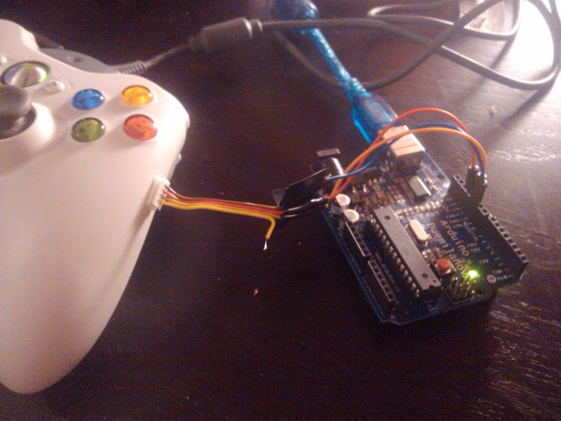

All in all, this is a pretty simple hack but it's my first use of a microcontroller.
I've had an Arduino laying around that I never did anything with besides a few of the beginner tutorials. I finally got to put it to use when I manually swapped out my Xbox 360 20GB HDD with a 250GB model. Apparently when you do an unofficial upgrade there are certain games that can detect this and corrupt the game saves thinking you're tampering with them. That's what happened to my Forza 3 save after accumulating millions of dollars, a large garage and completing 75% of the game. A couple hundred hours of gameplay were lost.
I begrudgingly started over and have been slowly working my way back pretty quick. One of the ways I am doing this is having the AI run enduro races while I'm doing other things and when I go to bed. It's a pain in the ass to keep checking on it and restarting a race every hour.
That's where the Arduino comes in. I'm sure something like this has been done before. I wired up a salvaged 4-wire connector to the A button and the up and down on the Dpad. This was pretty simple. I stripped some single wires off of an old HDD IDE cable and then poked it through the holes in the controller board. Then I hot glued them in place. I cut a small hole in the side of the controller for the female side of the connector and superglued it in place and put everything back together.
I then recorded all the steps I had to go through to get from one race to the next and all the pauses I would need to add while waiting for the game to load at various times. I converted this to a simple program and loaded it on the Arduino.

It works great and I'll have my game back in no time. I'd show a video but it would just be me filming the menu of a video game. Not too exciting.

You are pressing each button by pulling each button's pin low with an Arduino pin, but I see no ground connection between the controller and the Arduino. I guess that you are powering the Arduino from a USB port on the same console (getting a shared ground that way), or are just very lucky that it works.
neonpolaris
Posts: 7
Joined: January 28th, 2011, 7:20 am
Re: [Rookie Hack] Money Making Controller Hack for Forza 3
Postby nikescar » February 3rd, 2011, 7:38 am
That's exactly how it's setup. Should I wire into the controllers ground and connect that to the Arduino? I have a spare pin in the connector that's not being used.
edit:
It's actually being powered by my PC's USB port. If I need to change something do let me know.
