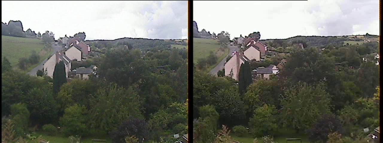

Here's a quick pic from the bullet cameras I set up yesterday (left it setup overnight):
(click for fullsize)
You need to cross your eyes on the pic to see the stereoscopicness of it.
Until I saw both images side by side on the same screen I didn't realise one was slightly out of focus and there's a slight colour difference between them, I'll have to investigate getting correct focus on them as I just grabbed them out of the box of 10 without checking.
The clouds are out in full force today and no rain so I'll be doing some more testing, hopefully get some good pics and pics of the rig.

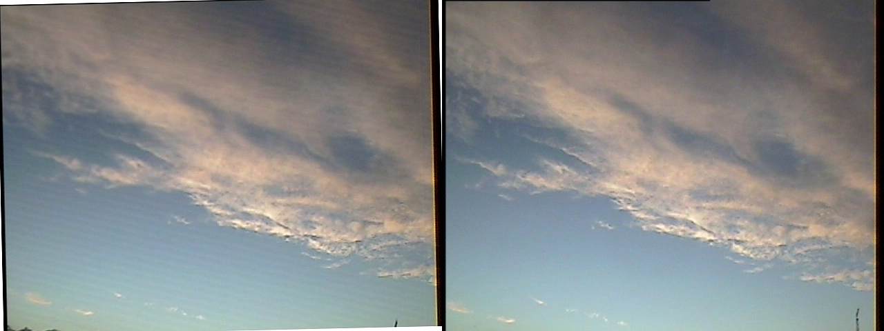

Went out late in the day on top of the hill next to me and this is the best pic I managed to get:
I rotated one image by 1.2 degrees to match the other, and I think they're the right way round to cross your eyes and get a picture, but the cloud is so far away that even with the cameras 22 feet apart it's almost impossible to see any depth.
The hardest part was getting the cameras aligned just right, and my right eye not having perfect vision doesn't help when looking at the cameras outputs on the LCD glasses. That and I could do with a couple of identical tripods to put them on, being low to the ground meant avoiding the long grass getting in on the picture.
I'll come back to this another day in the future sometime, I think I've got another headphone extension cable somewhere to extend the distance between the cameras further.

Haku, I think the trick is that the cameras need to be lined up with each other, whether the plane they're on is at angle or not, just like your eyes are, even if you tilt your head, your eyes are aligned.
